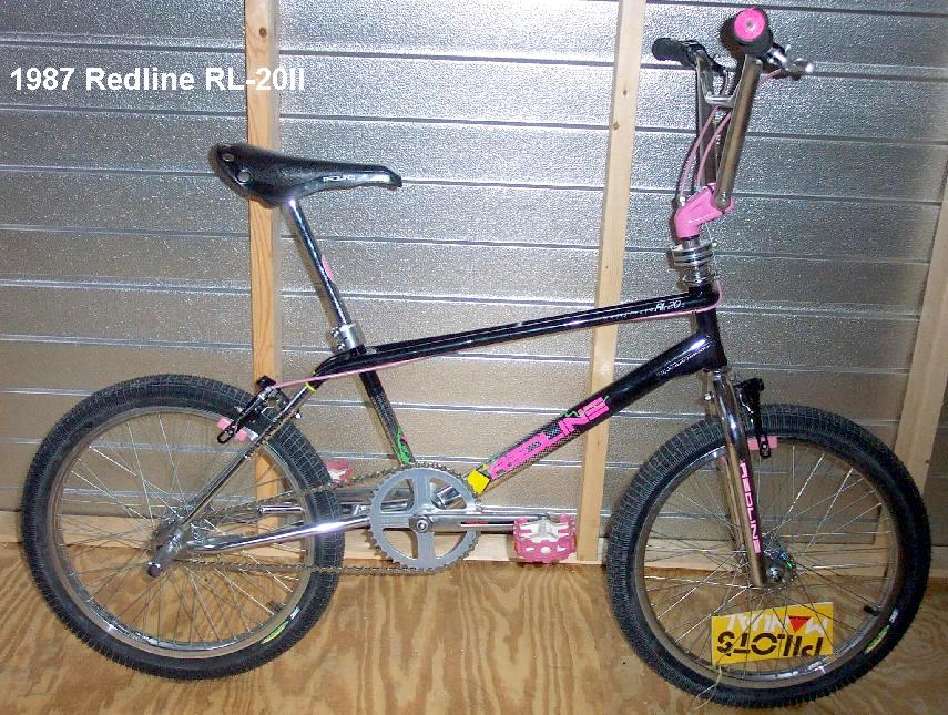

Aug 6 2006, 04:24 PM
That is the "iffy" year. However, yes there was 1987.
The common one is the black and chrome version (picture below, disregard my parts, I built it that way). It came sometimes as a painted BB (RL Paulie's) and sometimes without. The pegs are lower and small. Don't get excited if you have one and the pegs are "upper" and small, it is possible too. There are no 990 brake mount. ALL 990 frames are 1988 model, no exceptions.
Aug 6 2006, 07:09 PM
Brian just brought this latest ID thing to look for.
The 87's have a split in the brake cable guides. Look at a closer picture of my 87. The forks should have this same matching split cable guide too....
The forks on this 87 are not correct. They are actually a MX tapered Redline Fork. That was what I had at the time. I have correct forks for it, but never got around to changing them out...
