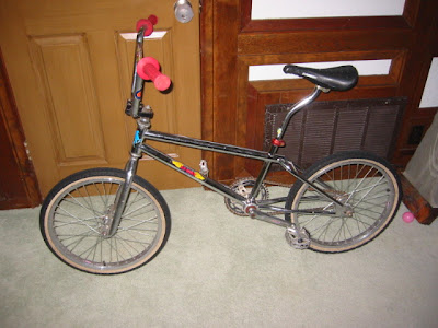

I apologize in advance if this is a stupid question because I am a newb to the site. BTW - I'm glad I found it! Love this site! Came across because I was looking for a few parts to try and replace on my GT because I started riding it again.
I have a GT bike that I purchased in late 86 early 87 when I was 13 years old. The rumor when purchasing it was the previous owner was a factory rider and it was a factory issued bike. I have no proof currently. There are no serial numbers on the frame anywhere, nada....
What does the lack of serial numbers mean?
How would I identify what year bike it is?
Any feedback would be appreciated. Thanks in advance, Adam
B. Apold
Its not totally un-common for the serial to be non-existing. Usually its on the inside of the freewheel side rear dropout. Look again, if not well you have a more un-usual version from what I can see of an 82-83 GT pro. Got a closeup? Neat bike! I had many of those.

I would have to agree 81/82 gt pro and if its no sn its a early model...

serial number should be on the inside of the drive - side dropout
It's a date code too

My bad, thanks for the location. I obviously didn't have the rear wheel off when checking.
Serial is 122681

12/82 # 681

is it Jan, 1982 #2681?

Jan 1982 #2681
OR
Dec 1982 #681
sanjosebmx
2681 frames, not from Taiwan, in 1 month?
It's a 12/82
82-83 frames were the same. The only difference on most were the seatpost tube decal. 82's had GT's wings and 83's were Nora Cups.
81's had the smaller diameter down tube to the bottom bracket. In 1982 they discontinued the euro BB on pro's after 81 and from that point on only used American BB, thus started using the larger tube. 81's and older are my favorite and harder to locate.
