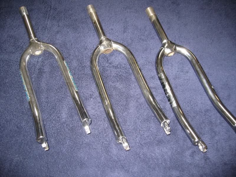

Here's some more of the TX-500 with date codes of '76, '77 and '78. The date codes are easy on these. It's a number "year" and letter "month" as the first digits of the code.

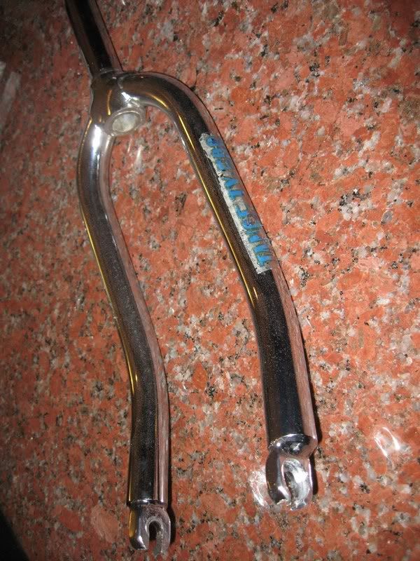

What does 2H mean stamped on them? has Tear drop dropouts.
Monster-Robot
QUOTE (redlinenz @ Aug 29 2008, 06:32 PM) *
LOL GLOV
August 1982
