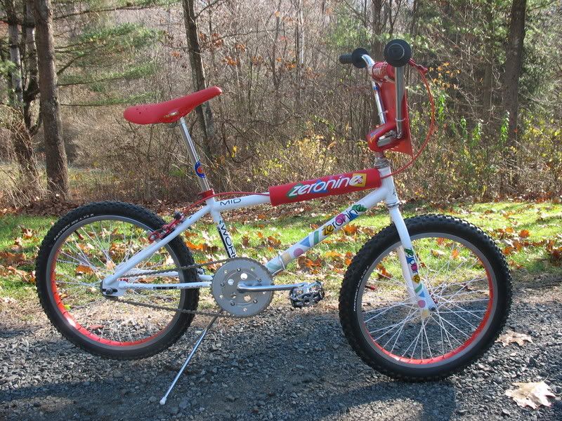

Figured I post it up before I tear it down again. Not happy with they way it came out. I need to change out the bars, cranks and wheels. Have a set of 175 cranks on the way. 180's seam way to big for the bike. The 1.75 are also to big for the frame. I have a set of 1.50 that I am fixing up. And the GT bars are HUGE for this size frame. Tell you what thou, this bike is a loop-out machine. Ended up on my but a couple of times!
Any suggestions are more than welcome
Old-skull
Break down:
Zeronine mid F&F
GT Santa Anna pro bars
Ame grips
DK pro stem
My last # plate that I actually raced with
MX 1000's
Zeronine pad set
180 Sugino cranks
Suntour Pedals
Tuff neck chainring
no-name power disk
Araya rims with GT hubs ( I refinished them)
Comp X's
Mid school GT seat post
Kashimax seat
Tuff neck seat post clamp
Ressurrector

thats a cyclecraft frame.. not a zeronine
race_inc
Nov 26 2007, 09:38 AM
Hmmmm........
race_inc
Nov 26 2007, 09:46 AM
If I'm not mistaken, the rear dropouts on the Zeronine frames were totally underneath the chainstay and were not connected to the seatstay at all as in the pic below:
Here's a Cyclecraft frame:
tntman
Nov 26 2007, 10:10 AM
race_inc.. you are correct
Ressurrector
Nov 26 2007, 12:16 PM
oh word?
old-skull
Nov 26 2007, 07:09 PM
Zeronine had 3 different types of frames.
The one like Race inc's pic and my blue one.
Then they had the same drop outs plus a guestt around the head tube.
Then they had one like the white one. Cyclecraft made quite a lot of frames for Zeronine. If you ever see a 09 cruiser they have the same drop outs as this. Essentially 09's ARE redecaled Cyclecrafts.
Plus I got this F&F off of BND. His buddie bought it new BITD.
