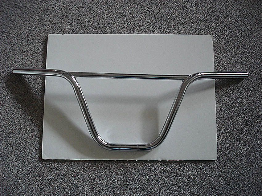

Aug 18 2006, 06:12 PM
pro class bars and yes there hard to get with the stamp.

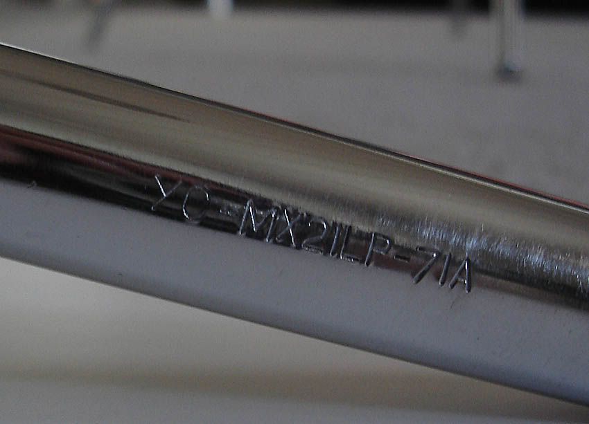

Aug 19 2006, 01:48 AM
I have this set of Pro Class bars which I picked up for a very good price.
I'm pretty sure they are mild steel off a Californian.
However, they are identical in size and shape to the full cr-mo versions.
Can anybody let me know what the serial number on them means (it is on the end right side under the grip area).
No Mongoose stamp at the clamp area.
[ August 19, 2006, 03:49 AM: Message edited by: AndyDiamond ]
